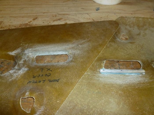

I have fitted the door panels and have wood doweling in place on the doors to hold them in place. I lost a lot of sleep over this pull handle for the doors and tonight it came to me as how I was going to do it.
The opening was cut out and ½ fuel tubing was bondoed in place to have a nice radius on the area where one will pull the door closed. 2 bid was added over the micro and area to hold in place.
Fuel tubing bondo in place

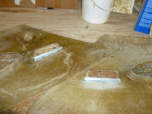

Sanded and ready for bid

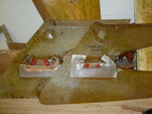

Glass work done and peel-ply on
