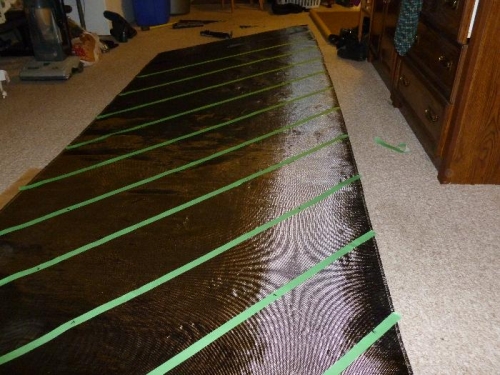

Brief Description:  I going too carbon bid the main landing gear

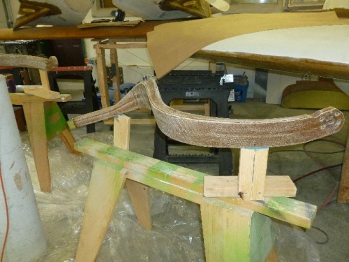

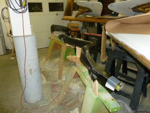

I looked up the mod for the factory Carbon bid reinforcement and got things ready for the lay-ups to be done on the main gear legs. I had to first remove the brake line support tubs that were on the main gear legs by grinding off. The carbon cloth was cut 10” wide and rolled up ready for the application. I jigged up on some saw horses and did the lay-ups as seen on the CD instruction video.
Marking out the carbon bid for cutting
Main gear is sanded and ready for bid
Carbon bid is done
Carbon bid is done
