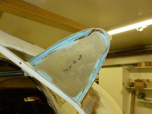

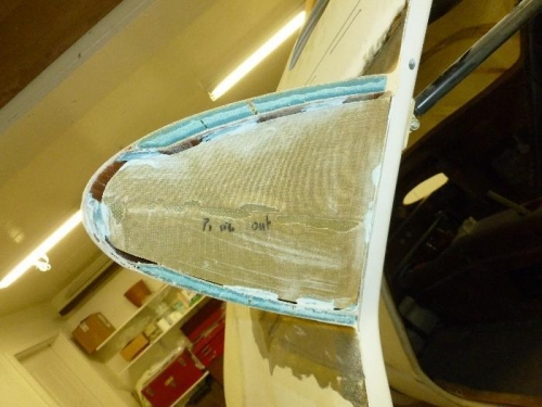

Before I close up the door strake area I rough cut the arm rest in the door to trace out the door strake end and to take the guess work out of were is it.
I then traced out onto cardboard from the inside and shaped the foam to fit the door ends and bondo into place for the 2 bid lay-ups next week.
Canada Thanks Given this weekend. Time to eat the bird!!
Traced inside for foam cut out
Pilot side cut out and sanded to fit
Co-Pilot side in place with bondo
