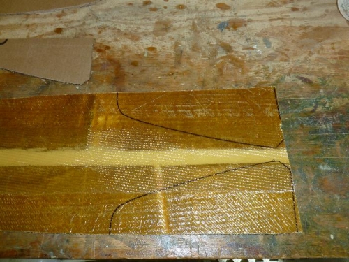

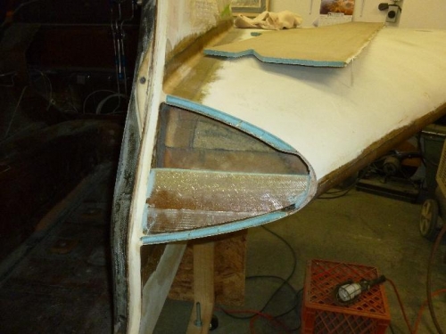

I made a template from cardboard and then transferred to the piece that was cut out of the fuselage side because it will be stronger then one bid on each side stuff made for the fuel tanks (strakes).You never know who will grab this spot to pull them self into the plane. The 2 sides where bondoed into place.

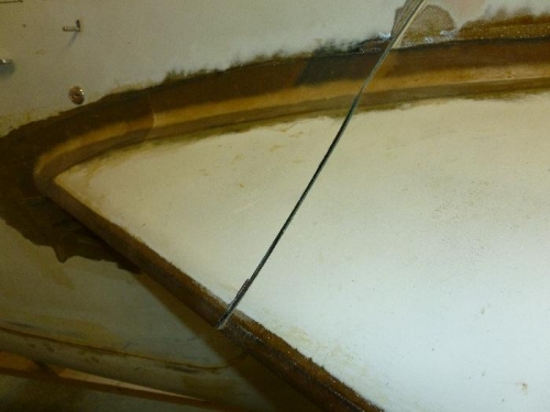

I then sanded the cut line to 3/16 or bigger for the 2 bid to go on for the lay-ups at the door and front strake storage area.
I ground out the foam for the micro and prepped for 2 bid on the door and strake area.
Cut out storage front from fuselage side.
Bondo in place
Bondo in place
Sanded out to 3/16 for glassing
