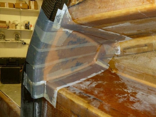

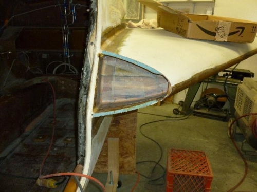

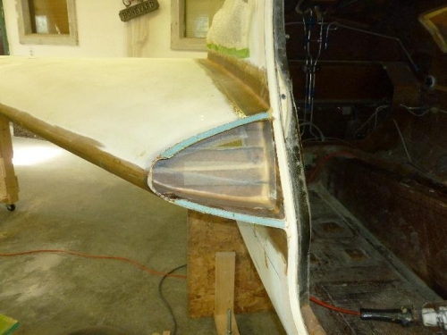

Brief Description:  UNI and Bid in front baggage bulkheads
I jump on this fist thing this morning as I had a busy afternoon to day. I mixed up micro and did the inside Pilot side first then wet out the 4 layers of UNI 2 at a time on plastic and off to the plane I go and placed in on the bulkhead. I just don't like UNI to work with it’s like a dog with a mind of its own, after spending some serious time working with the glass to lay down right I then worked on the front of this panel with micro and 2 bid. Out came the peel-ply and the heat gun to milk out the resin to the top of the peel-ply.
The Co-plot side was next and of course it was much easier as I had some practice from the pilot side.

Pilot side bid in with Uni on other side
Co-Pilot side done with peel-ply
UNI added to cabon beam
