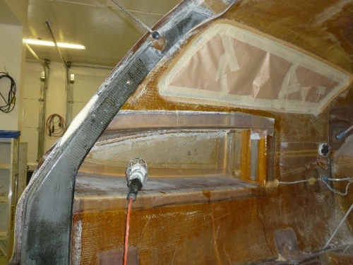

Brief Description:  More strake work
I was off to Nelson BC for their Air show Thunder in the Valley Aug 2nd /14 It was a great show for a small City adventure.

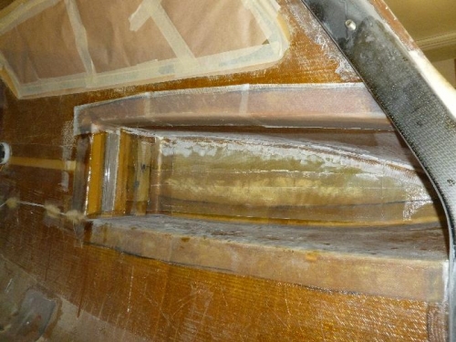

This got me going again so down to the shop I go. I ground down the extra flange that was in the baggage area from the top fuel strake. Got the fuselage to top strake area cut and sanded to have the micro and bid done to tie in the top strake.
Then out came the acetone again with a wipe down and mix up the resin for the job. I applied the micro to the foam and putty micro into the low spots on the inside of the fuselage. Painted resin on the areas to have the bid and got the lay-ups ready to go on. The peel- ply was the used to have s smooth surface when cured.

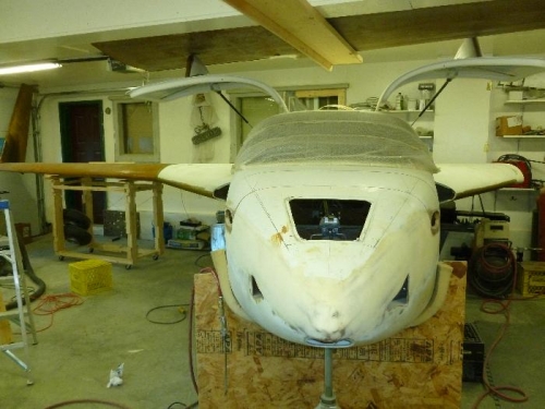

Co-Pilot door is cut and free
2 bids on in-side top strake
2 bids on in-side top strake as well
