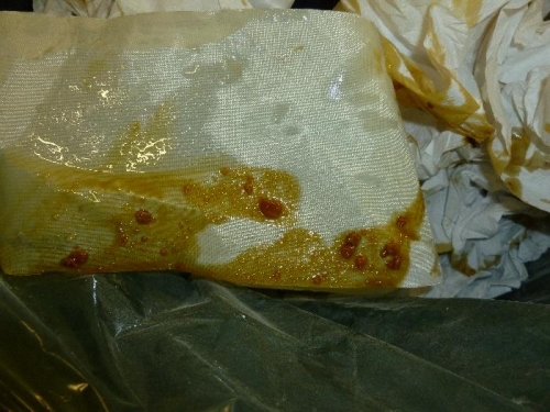

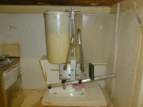

Brief Description:  Had to clean Sticky stuff Dispenser

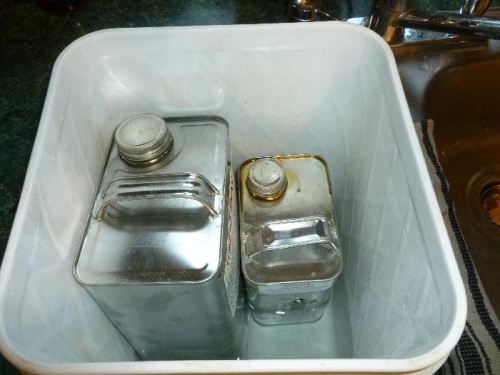

My Sticky Stuff Dispenser was not giving perfect shots of hardener, so let’s see what is in the bottom of the tank. I pump the tanks out back into there containers to find the bottom of the hardener tank full of crap. I drained the rest of the 2 tanks out into the garbage and clean the tanks out with paper towel and then Acetone. The picture only shows 1/5th of what was in the bottom of the hardener tank. I then washed down with Acetone and pumped clean Acetone trough the system. It is now ready for clean resin again. I heated the resin in a bucket of boiling water from the kettle to dissolve any solids. I had some nylon window screen and cut out 2 pieces to use for screening out crap for both tanks.
The pump was primed back into the containers and is ready to go back to dispensing again.
Crap on bottom of harder tank
All cleaned up and ready
Hot water tank to warm up
