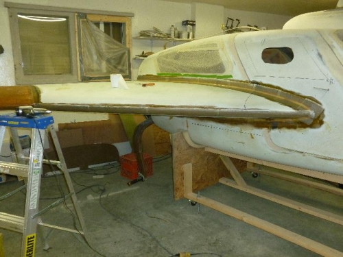

Brief Description:  Glass in top strake to fuselage
I cleaned up the weights from the top of the strake and removed peel-ply from yesterday. I then cut the junction at the wing to strake area where the 3 bids were laid up to close the gap. I marked the back of the strake were it attaches to the wing and cut this area as well.
I sanded all areas were the next glass work was to be and wiped down with acetone. Mixed up some micro balloons and filled in the corners with a nice radius mixed up some resin and started to wet out the 2 bids to be put on.
A friend Brian came by and talked for only 20 minutes and the resin was starting to set up fast with the summer heat in the shop.
I really had to add lots of heat this time to have the resin flow out and saturate the peel-ply.
I ‘m really happy with the time and results these few days getting things done on the plane.

2 bids with peel-ply
