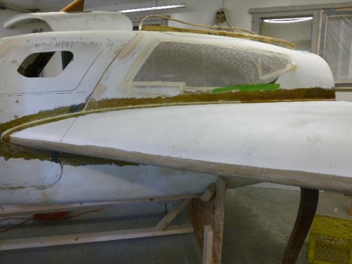

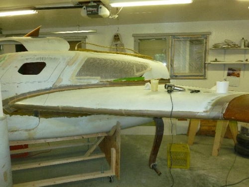

Brief Description:  Glassed in top strake to fuselage
Well I got at it tonight sanded all the areas needed to be sanded and blew down the spots then out came that good old acetone for the wipe down. I painted resin on the area and then applied the micro-glass with the bid on top followed by peel-ply to finish it off.
At the wing area the gape is over 1/8” so I added 3 bids to the top strake and will cut to 1/8” and fill with Alpha Poxy for shaping and sanding.
Micro-balloons and bid on top
Peel-ply on bid
Peel-ply on bid
