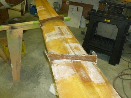

I sanded the TRAX back to a nice taper and used the cut out guide for the shape of the top to see were I will need to fill to have a smooth top surface of the Canard.

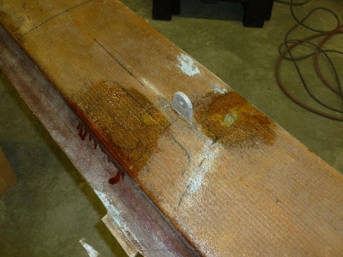

I got a needle from the drug store and filled with resin so that I could inject in the small hollow sounding spots were there is an air bubble. I had to use the heat gun to get the resin to flow out nice. As it heated you could see the resin slowly flowing out filling the hollow spot. I used weight on top of plastic to hold down in a few spots, this will work great to glue the two layers together.
A good scuff and wash down and the Canard will be ready for filler and then primer.

Repairs sanded.
Repairs sanded.
Resin injection.
Resin injection.
