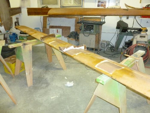

In the pre cover inspection a few air bubble pockets were detected and had to be fixed. I got out the Building Bible and found fiber glass repairs and followed the repair procedure in the book.
The bubbles were ground out and the edge sanded back for a smooth transition. The book said 1.5” over lap I think I got up too 2.5”. It will hold the Triax strength for sure. The repairs will take more filling to make the paint look good.

Canard top all fixed up.
