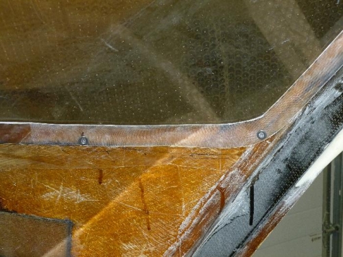

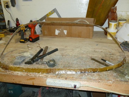

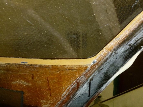

Tonight I got the front window trim cut and fit into place. The spacing was 10.25” with the center as the starting point. I see that I will have to over size the trim holes to help find there spot. The washes will hide any over sizing on final assembly. The front screws will have to be ¼ shorter then the rest.
Trim cut
Trim cut
Blind nuts in place
Blind nuts in place
Trim in place
Trim in place
