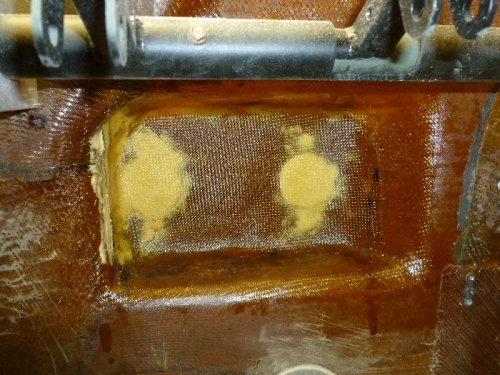

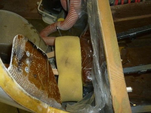

Fill in master cylinder hole
I will need to fill in the bulk head master cylinder holes as they will no longer be used. I got the site ready by sanding and acetone wipe down and 2 bids with micro on both sides to seal the holes up.
Plastic and foam to hold bid in place
Micro in holes & 2 bids
