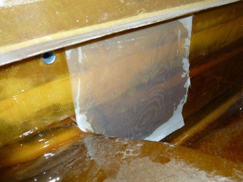

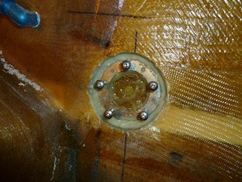

Brief Description:  Relocate Pilot fuel flange and then 3 bid
Well I don’t how I did it but when I drilled the holes for the flange trough the fuel gage I got it out of place. So out came the 3” hole saw and I cut it out of the fuselage. One more reason I like this kit you can screw up and there is a way to fix it.
I don’t know what it is but this fuel strake has had it moments will me.
I used 5 minute epoxy with flox to hold it in place on the duct tape (fuselage side) once curded the rest was done with T88 and milled fiber. 3 bids are then applied to both sides of the fuselage for fuel proofing and strength.

Cut out and back in with 3 bid
3 bid on Co-Pilot side
