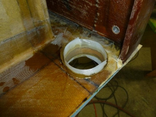

Brief Description:  Bolt hole, screen bid, micro upper strake

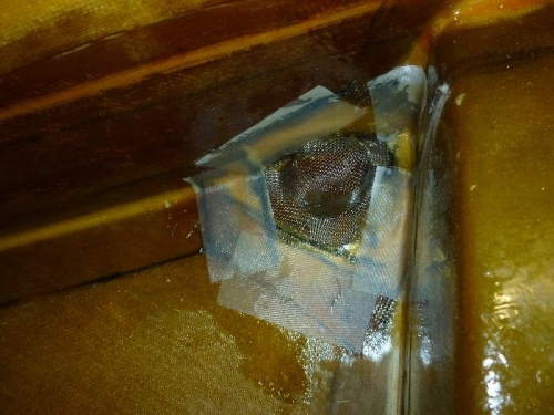

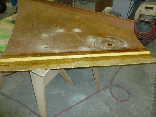

I started with a 3” hole for the hand to install a bolt on the lower strake. Micro 2 bid and peel-ply let set for the night. I used the micro on the fuel screens and did a 2 bid lay-up here as well. Mixed more micro and added to the upper strake where I removed to much foam earlier. I will have to add micro now or later when the top stake goes on.
bolt hole
bolt hole
bid on screen
bid on screen
micro top strake
micro top strake
