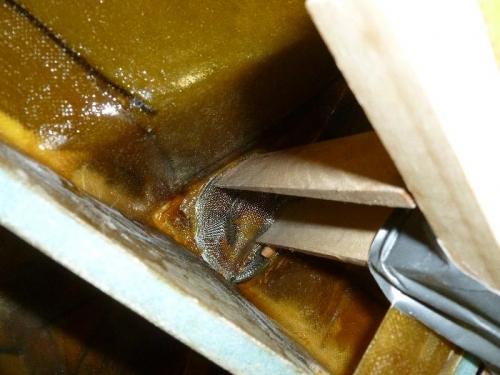

To night I started with cutting and sanding the fuel out-let screens and then floxed them in place. I had to use sticks and a strap to push the screens down and into place so that they sit flat on the floor and sides. It was time to work on the fuel cap so out came the drills and I made some holes in the upper strake, clean everything up and also floxed in the cap with micro filling up the space with 2 bids of cloth on top then peel-ply.
Front out-let screen floxed in
