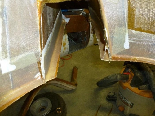

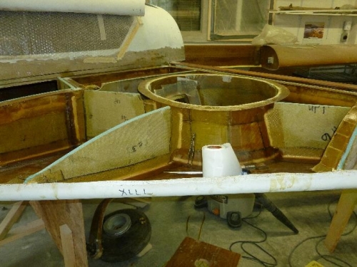

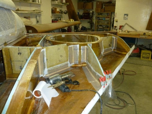

Now it was time to mix micro for radiuses paint resin on effected areas fallowed by 2 bids and then peel-ply.
This took longer then expected and Cynthia was waiting to get things done.
A very handy tool to use on the bid application is a pare of sharp tweezers. Lots of times when I pull the plastic off the bids are off to one side and the tweezers are used to lift up the 2 bids and pull over with the help of the brush to center in the radiuses location.
