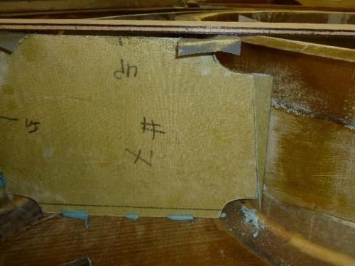

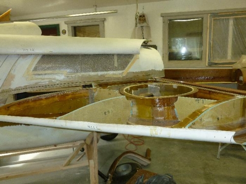

Today I started final fit on the baffles and bondoed in place for the micro radiuses and 2 bids lay-up.
I ready like working with this construction because you can just add were you over cut in the fitting processes. The picture shows how I just added a scrape piece of left over foam covered board in the gapping hole just add bondo and it is ready to go.

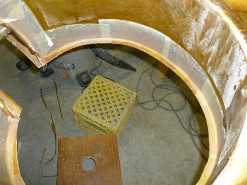

Once the 3 baffles were bonded in place I let sit for lunch and came back to using the dermal tool with a metal bit to remove excess bondo from the joints. Sanding was next then vacuum up all the smage that was in the strake, wet down with acetone and mix up micro and the work begins.
Before I started the lay-ups I had to cut the bid from yesterday in the wheel well to prevent a possible cut to me when coming up through the wheel well.
