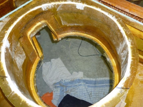

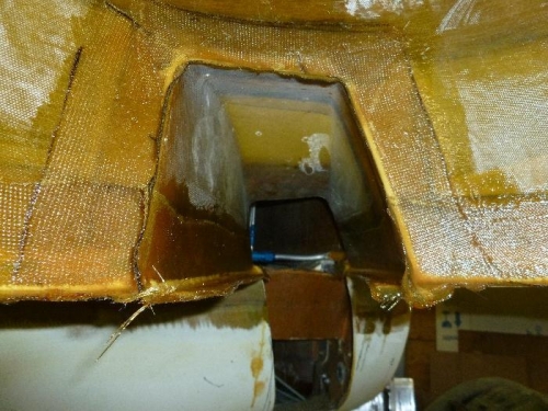

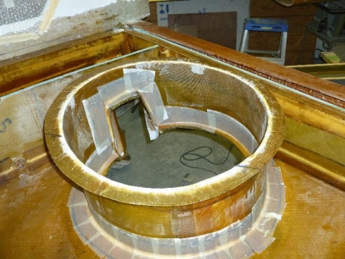

Back to building, I got out the micro mix from the cool storage that was mixed earlier and added some resin mixed up and off to the plane for the corner radiuses on the inside of the wheel and gear wells. I followed with bid and peel-ply.
This is my first day of building for 8 hours on the plane day light is getting longer.
Oh we had 1.5” of snow this morning yard work will have to wait!!!
Gear leg gets bids to bottom strake
Wheel well gets bids to bottom strake
Peel-ply is added
