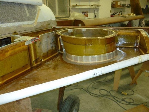

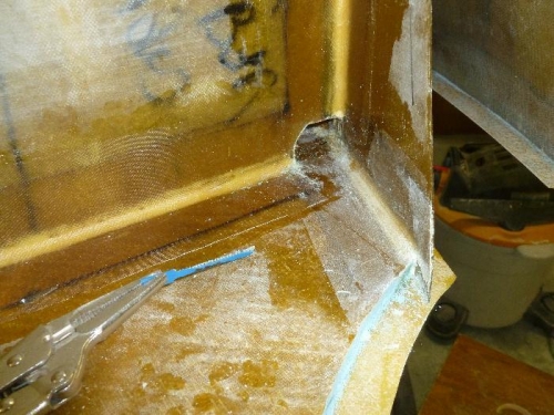

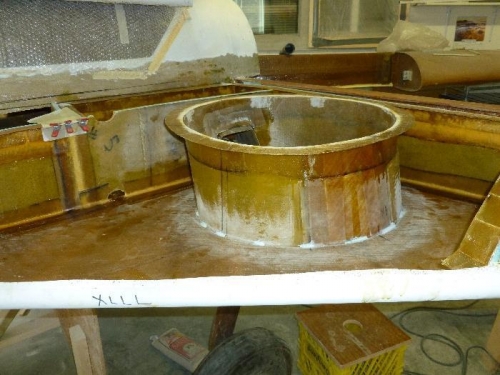

This morning I started out making the missing fuel mouse hole with a drill pilot hole and a jig saw blade. I moved onto final fit of the wheel well to be bondoed in place with glassing after with micro and 2 bids.
When I mix resin for the next 6 times I will paint the fuel out flow before the screens go in place for fuel proofing.
I must say the space between the wheel well and the back bulkhead had me worked up trying to get the lay-up in the right spot after 5 tries I finally got it and just for extra I added one more lay-up back there for strength.
Mouse hole is made.
Mouse hole is made.
Wheel well bondoed in place
Wheel well glassed in
