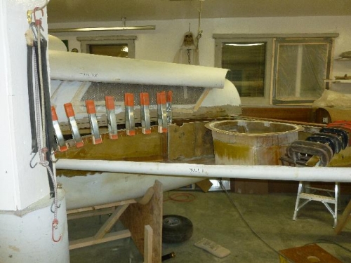

I got the 1 ½ “ fuel bulkhead flanges cut and fit for installation, everything was sanded and wet down with acetone for the flox to go onto. I applied the flox and used the clamps to hold in place.

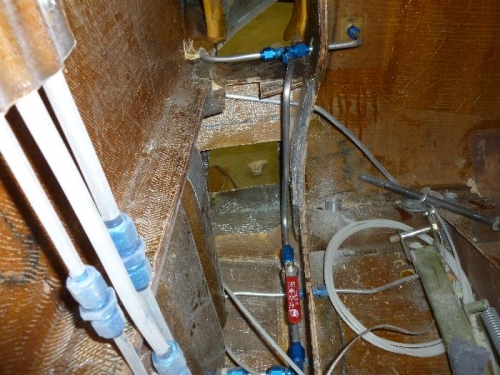

It was time to work on the fuel line to the tank, so out came the flare tools and bender and got this done tonight.

Flanges installed and baffle work
Fuel line to tank
Fuel line to tank
