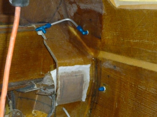

Not much time tonight but I did get a few things done. I cleaned up the hard point holes, removed the Vaseline from the threads and installed fuel and vent fittings. I then drilled a through hole in the bulkhead for the fuel line to go and connect on the other side. The drill shattered going through the wood and glass bulkhead so my old hole saw from 30 years ago did the job for me. I sanded it all up wet down with that good smelling acetone and mixed up resin for the lay-up. I had a few brush full left so in went fox to fill the cleco holes on the flange.

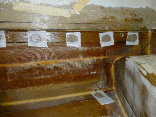

Triax & bid over through hole
Holes plugged with flox
