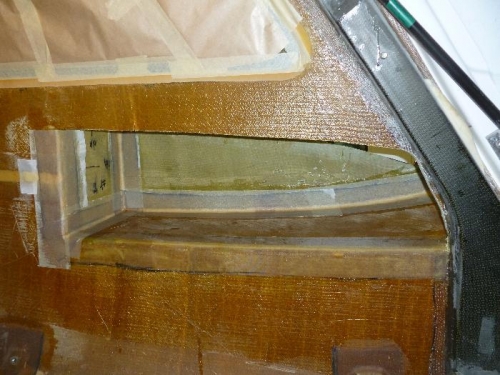

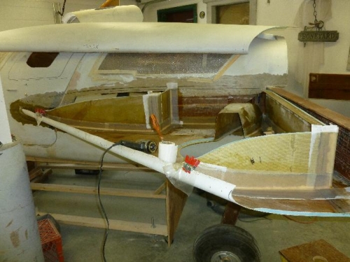

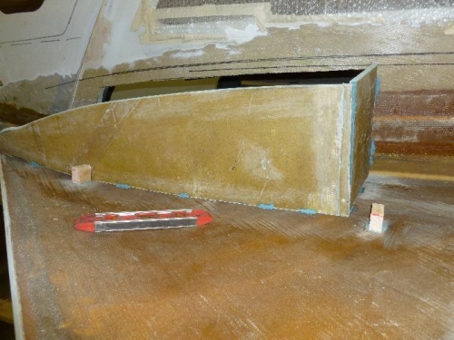

This morning I stated out making coffee for Cynthia and tea for me and off to the shop I went to get some work done on the fuel bulkheads. I stared by bondoing the baggage bulkhead in place and got things ready for the bid work by sanding and wiping down with acetone. Now the work begins with doing the radius in the corners and 2 bids on all of it followed with peel-ply. It went great today and I feel I got something done so off to the house work in the back room I go.
Baggage bulkhead bondoed into place
2 bid on fuel bulkheads
Inside baggage bid done
