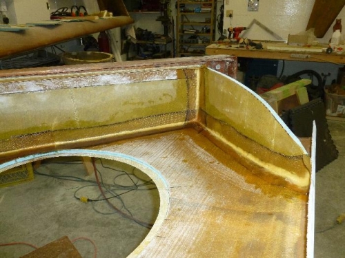

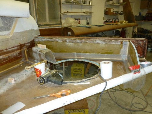

Brief Description:  Fuel line and back, outside bulkhead 2 bids
I started with microing in the fuel line with 2 bids on top. Then it was time for the back fuel bulkhead so I bonded in place with the outside one also. Got more micro mixed up and did the radius followed with 2 bids and peel-ply. Another good work night on the plane and now Cynthia time.
Fuel line done now the back
2 bids on and ready for peel-ply

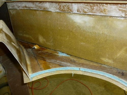

Peel-ply done
Peel-ply done
