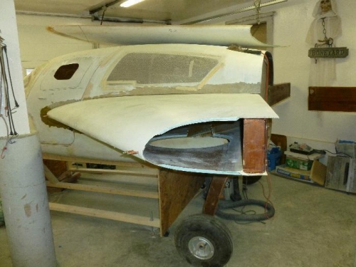

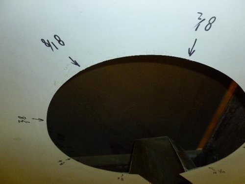

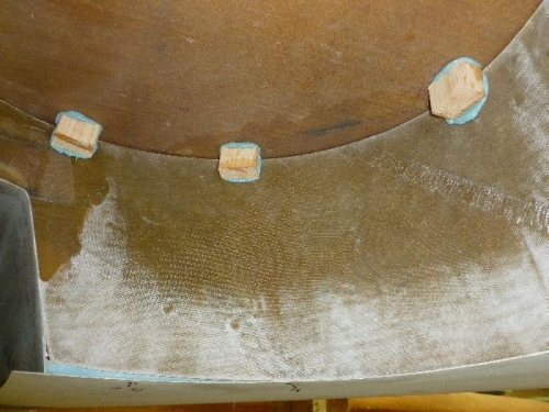

I put on the top strake and measured up from the bottom strake flange to the top strake. I moved the measurements from the lower strake to the wheel well and cut. I only had 2 spots to sand and the gap worked out to 1/16-1/8. I mixed up some bondo and installed the blocks to hold in place when the top stake is lifted off.
Top strake on.

Measurements from bottom of strake to top.

Bondo blocks in place.
