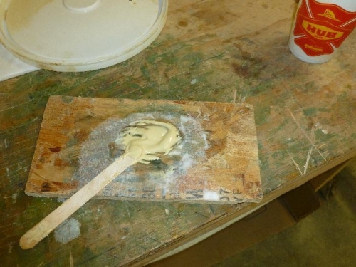

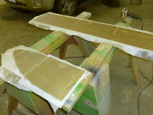

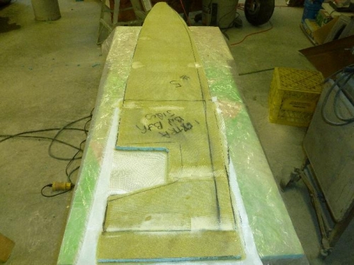

The manual calls for one more bidirectional cloth be lay-upped on the bulkheads to help with the fuel proofing. I sanded the bulkheads and added micro in any low spots to avoid air bubbles under the glass. I then painted the bulkheads and laid down the cloth and stippled until wetted out. After 30 minuets I applied peel-ply with the heat gun for the resin to soaked trough. I did have to add some resin to the peel-ply to wet out completely a few dips of the brush was all that was needed.
Micro for the low spots
Back reinforcement done. Now the front
Bulkheads with one more bid
