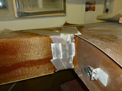

Glass wing bolt holes with UNI cloth
I sanded the area and added flox to the low spots and them added the UNI cloth to the wing bolt holes for strength.
Peel-ply on UNI cloth
