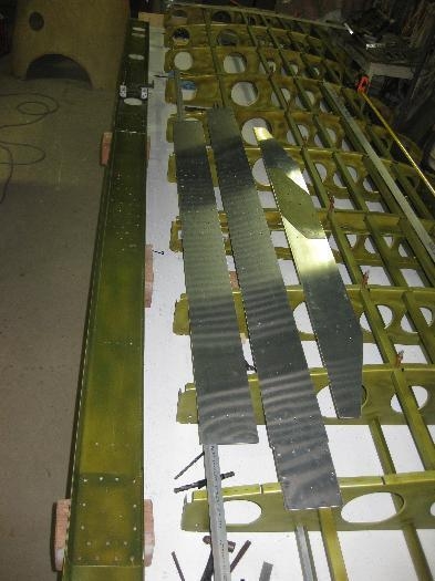

Brief Description:  Spar Strengthening ??

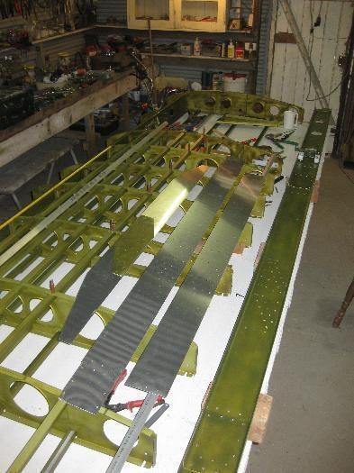

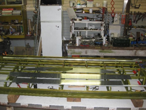

I have stated before that I do not belong to the 'Blind Faith' brigade, and believe that there are good grounds to be concerned and as a result I recently engaged another independant Aeronautical Engineer to view my wing structure and to give advice on my proposed method for re-inforcing the spars.
Increasing the Spar cap (flange) rather than the spar web is the best method to gain more spar strength, however this has proved too difficult with the current wing structure arrangment, so I settled on placing laminated plates to the inside of the spars.
Layout of re-inforcing backing plates for the rear spar
