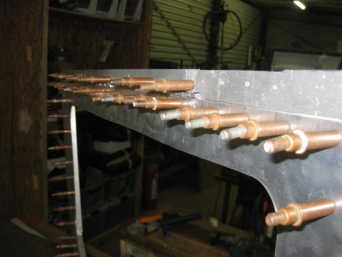

Over the last two days I have worked on fitting the door skins and making an additional cover strip along the top of the door frame that covers the hinges and cuts down on the gap between the door frame and the opening window frame.
I maked the frame outline onto the internal surface of the door & window skins, drew centre lines & then predrilled the rivet spacings along these lines.

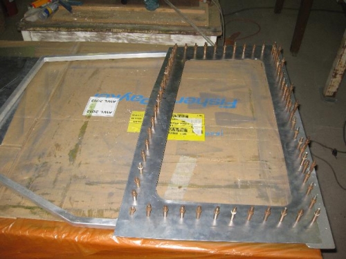

Right side opening window skin drilled.

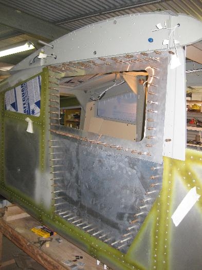

Skins in place on right side door
