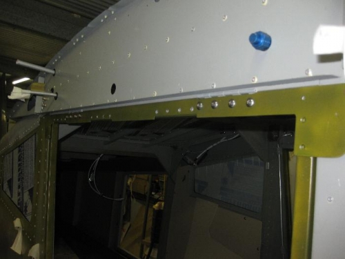

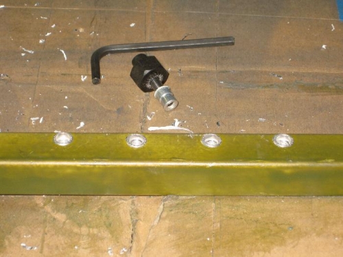

So that the doors and or the opening windows can be quickly & simply removed, I decided to use "Nut Serts" in the door frame for attaching the hinges.
Whilst this has taken quite a few extra hours, I'm sure that in the future this will be a good investment.
Nut sert for screw attching hinges
Cover & reinforcing strip along top of the door frame

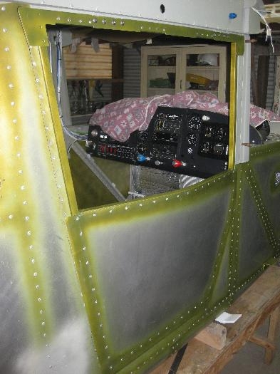

Lower door skins riveted in place.
