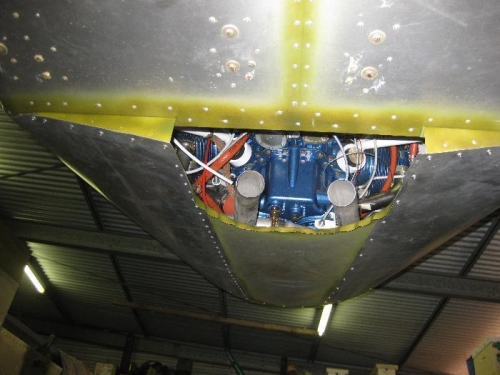

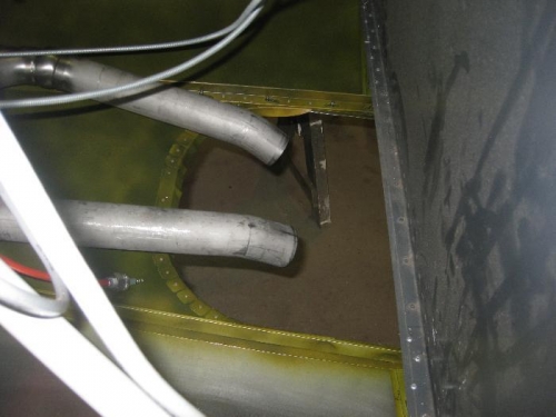

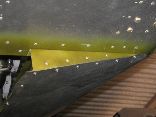

Over the last few days I formed and completed the opening in the lower cowls for the exhaust pipes and airflow discharge, making sure that the opening is nearly 50% greater than the nose bowl inlet areas.
Outlet area
Outlet area
Where the pipes go!
Where the pipes go!
Lower cowl corner
Lower cowl corner
