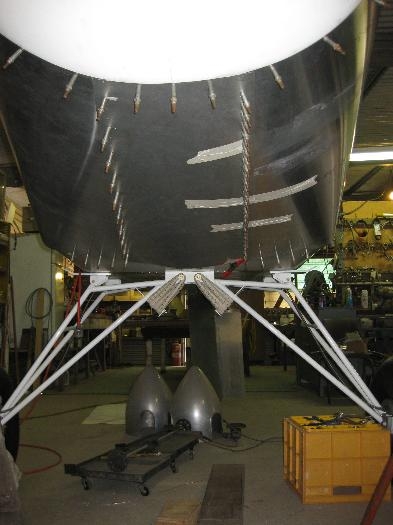

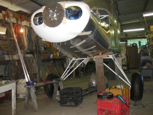

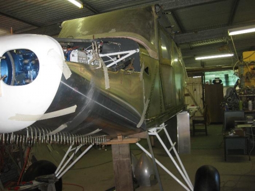

Brief Description:  Fitting the lower left cowl cheek
A fair amount of persuation in the form of clamps, blocks & wedges was required to get the sheet to hug the curve of the fuselage, but it was worth the toil !
I used the same pasteboard template for the right side cowl cheek.
The end result, with the cowls only held in clekos is very rigid.
Lots of tape & clamps necessary.
Using wedges to get the cowl tight against the gusset.
Lower cowls held in clekos
