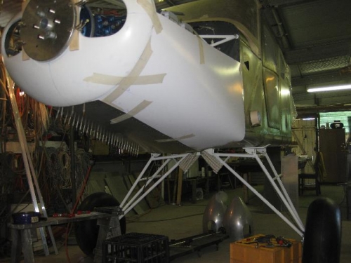

Brief Description:  Making the side cowl template from pasteboard
After finding a place where I could secure a large sheet of 400 gsm paste board (stiff cardboard), I then measured and cut out a template that I trimmed to fit the left lower cowl position.
I then used this template to mark and cut the flat aluminium cowl sheet.

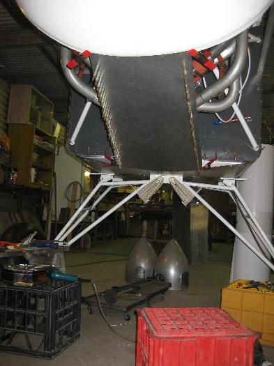

Bottom Cowl plate
Bottom Cowl plate

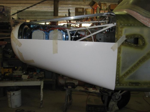

Side cowl template
Side cowl template
