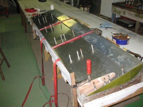

Brief Description:  Final assembly of left aileron.
Finished the deburring of the skin holes, primed the inside surface and re-assembled the left aileron, ensuring to clamp the small amount of twist into the structure whilst rivetting.

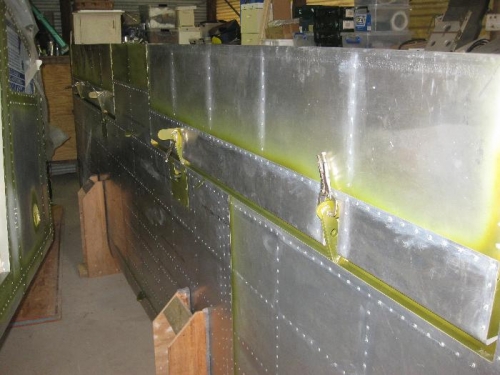

When finished, I positioned the completed aileron onto the hinge brackets of the wing and clamped it there to view the alignment of the trailing edges.
All good.

Final Assembly of left aileron
Good alignment on the wing

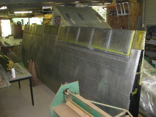

Left wing with Aileron & Flap in position
