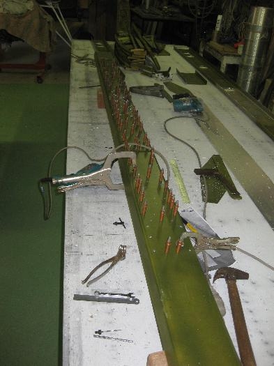

Back in the workshop, started on the right wing spars.

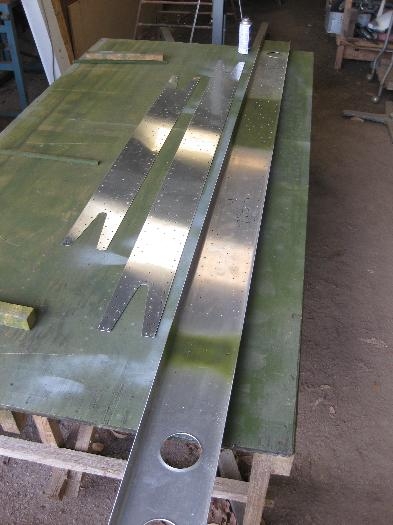

After learning mid last year that the kit supplier had been lying about the wing loadings, I had engaged some aeronautical engineering assistance to come up with a method of strengthening the spars without having to redesign the wings.
Just like the left wing, I used laminated plated inside the web of both front & rear spars.
If you are a BushCaddy builder looking at this web log for the first time, I would recommend you read the full story in the wings section herein as well as take a look at the Yahoo 'flybushcaddy' blog site for more detail.
Assembling  Rear spar reinforcing plates

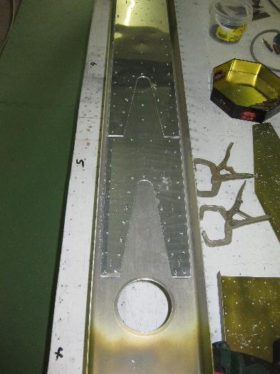

Front spar & reinforcing plates
Plates inside the front spar.
