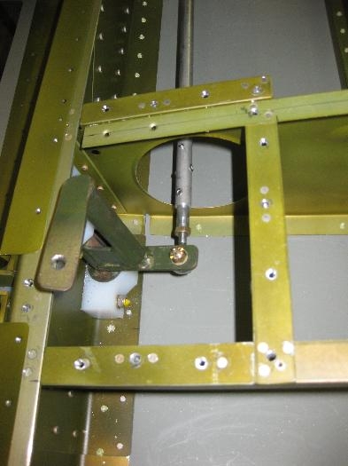

Flap & Aileron push tube fitting in left wing.
Finished fitting the push tube rod ends and then bent the bellcrank to the correct angle for the connection to the flap & aileron.
Spent a number of hours doing the final deburring on the ribs & stringers, and then vacuumed out the wing.
Duoble checked all bolts for correct torque & torque seal applied.
The first wing is now ready for final closure.

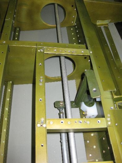

Aileron bellcrank & push tube assembly
Flap bellcrank & push tube assembly

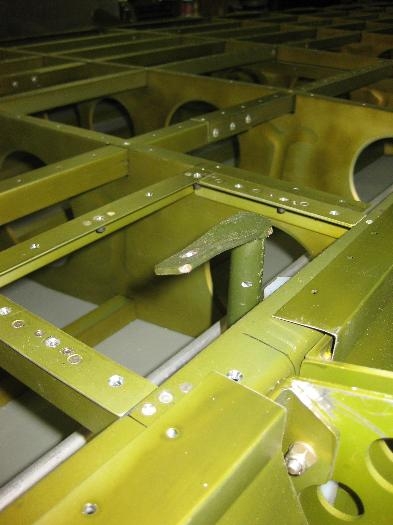

Bellcrank end bent to correct angle.
