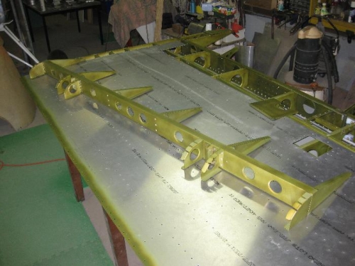

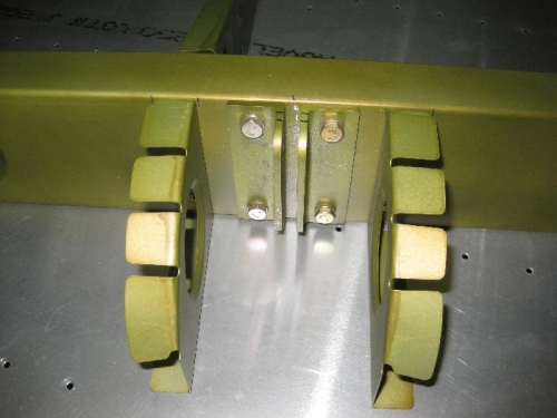

After cleaning up the workshop and cleaning out all swarf from the wing in preparation for the pre closure inspection for tomorrow, I then set about the assembly of the first of the flaps & Ailerons.

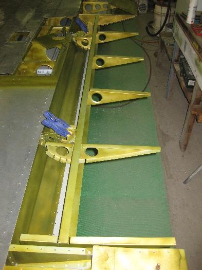

The assembled framework fitted into place in the flap opening exactly.
Due to the washout built into the wing, it will mean that when fitting the skins on the flaps & aileron, the framework will need to be slightly twisted to match the wing trailing edges.
Not sure how I will do that as yet.
First Flap framework assembled
Flap frame mated to the wing opening.
