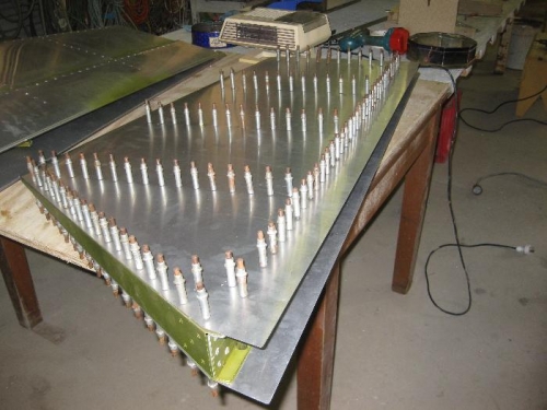

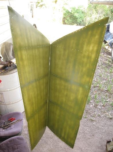

Prep of right side elevator for riveting.
Deburred the skin and framework of the elevator and etch primed the inside of the right elevator skin.
Skin clekoed to frame before drilling out to 1/8"
Internal surface of right elevator etch primed.
