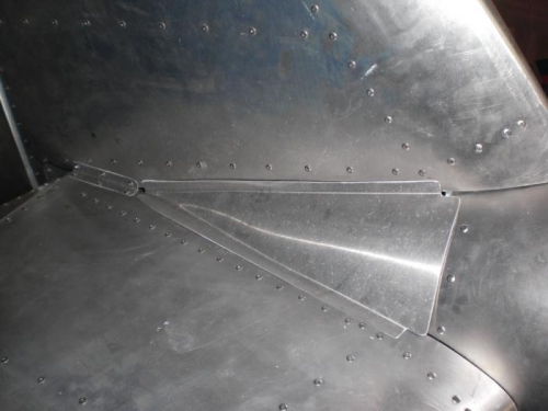

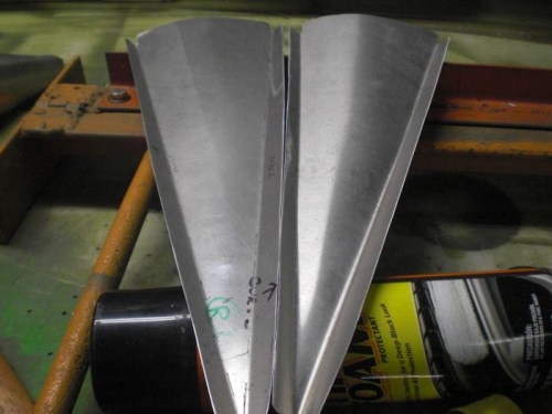

I redid both tail fairings using a large peice of metal that I rolled like a waffle cone to get the basic round shape then cut the fairings out with snips and cleaned them up on the flap disc and deburring wheel. So much better looking now. I can finally move on to a different section. I started on SNX-W11 and my band saw blade decided it was time to take a union break so tomorrow I will stop at the aviation section of lowes and get another.
Old on left, new on right
Nice fit!
Nice fit!
