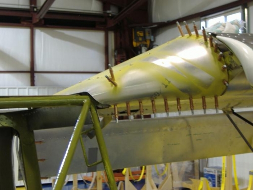

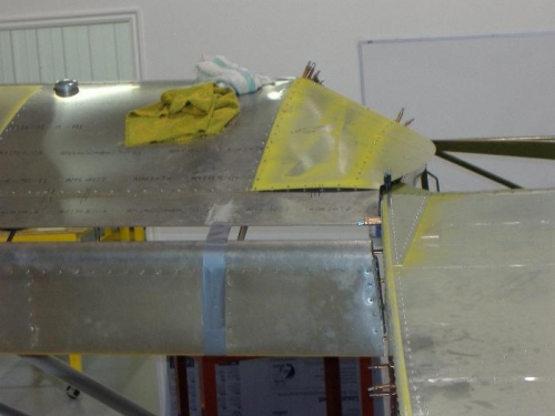

With the wiring and gas lines in the left wing complete, we put on the final piece of skin on the top of the wing, using the rivnuts. They worked fine. We then bent the skin around to the bottom skin and drilled and clico'd it into position. This is how we left it since this must be removed so as to install the top plexiglas and probably the windshield too. Furthermore the rivnut section will be open for final inspection even though the front part will be riveted.

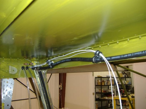

The wiring was completed in the right wing also but that is now on hold awaiting the installation of the outside air sensor when the avionics package is opened.
Continued running the gas lines, pitot tubing and wired around in the cockpit. All tubing will be on the left side and all wiring will be on the right. This is also tedius work in a confined space.
Inboard skin section
Wiring and gas lines
Rear view: inboard skin
