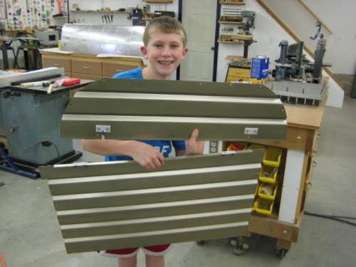

Rivet Corrugation Nut Plates, Wear Blocks
1548 - 1618
Cleco nut plates to lower corrugation.
Rivet nut plates using p-squeezer.
Cleco wear blocks to upper and lower corrugation.
Rivet wear blocks using p-rivet puller.
