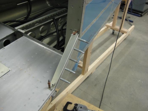

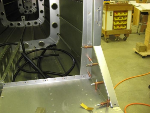

Rivet Lower, Upper Baggage Door Seal Channels
1124 - 1230
Cleco lower baggage door seal channel and shim to skin and floor.
Rivet channel per plans, using 3x gun, p-squeezer.
Cleco upper seal channel in position.
Rivet upper channel using p-squezer, p-rivet puller.
Install insulation on skin inside of seal channels.
Cleco closeout panel in position.
Rivet panel using p-rivet puller.
