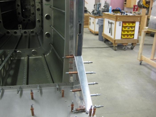

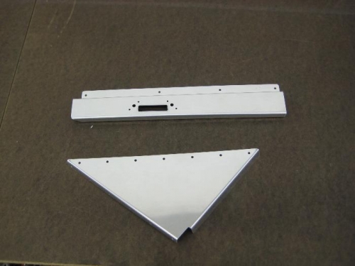

Trim baggage door seal channel per plans.
Debur and smooth all edges of channel and close out panel.
Final drill common hole to seal channel upper and lower.
Cleco F-1031 to structure.
Cleco close out panel to structure.
Match drill holes in close out panel lower flange to floor using #30 drill, cleco as drilled.
Final drill common holes of close out panel to structure.
Final dril common holes of upper seal channel and structure using #30 drill.
Remove all clecoed parts from fuselage including seat bottoms and baggage floors.
