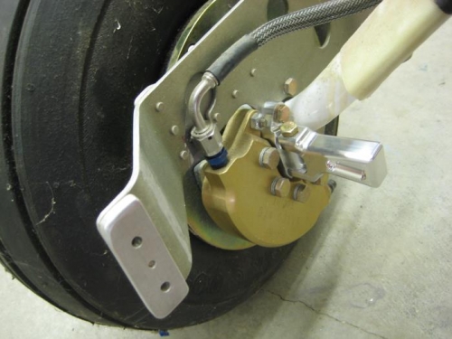

Brief Description:  Install RV-10 Jack Points
1530 - 1800

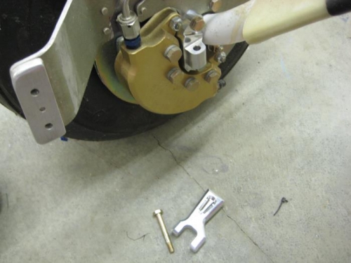

Installed jack points that I sourced from wintermotorsports.com.
I had to remove each main wheel and installed the jack points per the instructions. I purchased two lifting arms in case I want to lift both sides at once.
