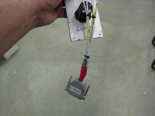

Today I populated the DB25 connector for the passenger headsets and music input. This connector is labeled CONN 2.

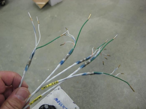

Wire lengths were determined.
Using standard techniques, shield wires were installed on each cable using solder sleeves.
Wires were then stripped and female receptacles installed using AFM8 crimper.
The DB25 was then populated using the previously created pin out diagram.
The wire bundle was then wrapped with SVT and clamp installed.
The backshell was assembled and additional SVT installed for strain relief.
Wire bundles were temporarily tie wrapped for organization.
