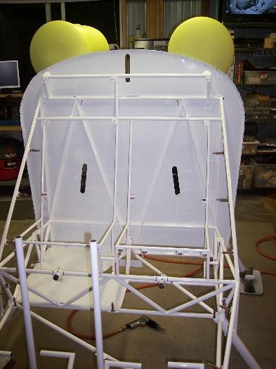

Brief Description:  Application of Topcoat
After priming it was time to apply the topcoat to the interior of the panels. I want the area under the seats to be light in color. The topcoat I selected was MIL-PRF-85285 Color 17925 Insignia White. This bright white polyurethane topcoat has excellent resistance to solvents, oils and grease. It's high gloss finish will make for easy clean up.

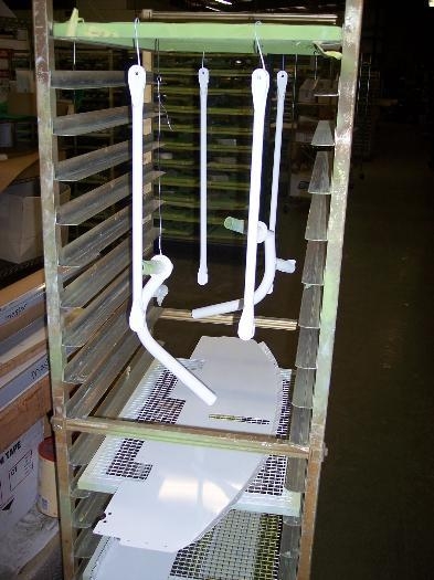

Racked to minimize overspray
The reverse side is primer only

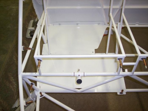

area under copilots seat
