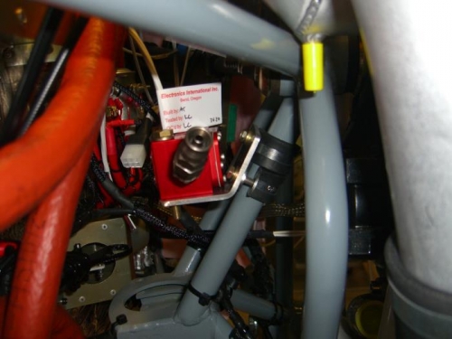

Brief Description:  Fuel Flow Transmitter Mount

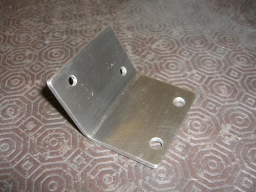

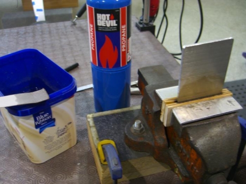

I'm going to mount the fuel flow transmitter on the engine mount & use flexible hoses for the installation. Today I cut a piece of 0.125" thick 6061-T6 aluminium for the mount & annealed it for bending. Once bent to the required angle I drilled the required holes, test fit it & then alodined it ready for installation.
Annealing prior to folding
Drilled & folded
Drilled & folded
Test fit O.K.
Test fit O.K.
