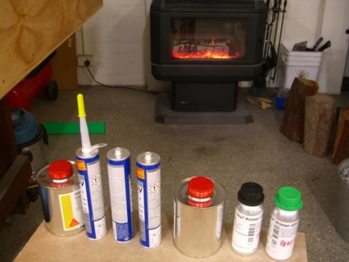

Tomorrow GAM is coming to help me install the windscreen so today I finalised the masking. As it is winter & we are having somewhat of a cold snap with morning temperatures of around 2 degrees C, the workshop is too cool at 10C for using the Sika products so I have lit a fire and will keep it going through the night in the hope of having product and surface temperatures above15C tomorrow. This afternoon the temps were above 20C so I'm hopeful all will be good for tomorrow.
Product warming in front of the fireplace

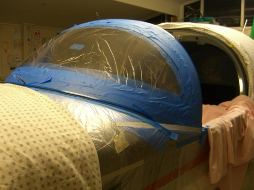

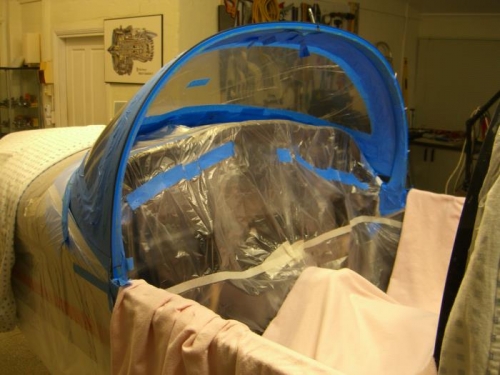

Last of the masking complete
Ready to go
Ready to go
