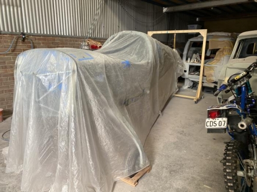

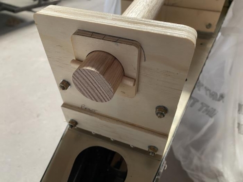

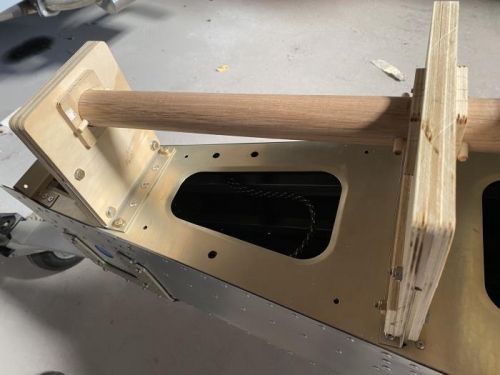

A way of supporting the rear fuselage whilst painting with the tailwheel removed is needed. I produced a timber support that bolts to the horizontal stab mounts which is in turn supported by rope hanging from a gallows frame I produced from pine & plywood. This will also act as a convenient handle for steering the fuselage around the paint shop. Again no hours included in the build tally for the days taken to produce these items.
Bolted to the mounts
Dowels lock the handle in place
Hanging from the gallows at the paint shop
