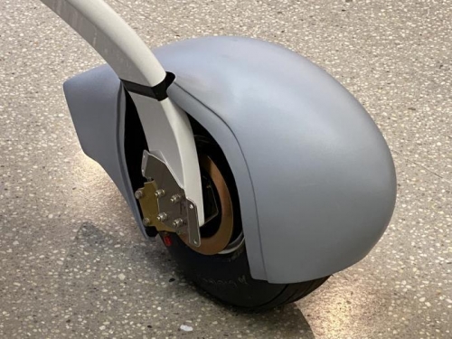

In a desperate attempt to have this aircraft fly faster that PGC's Sling 4, even if only by 1 knot, I'm installing wheel spats, a trial fit shows they should be relatively straight forward to install.

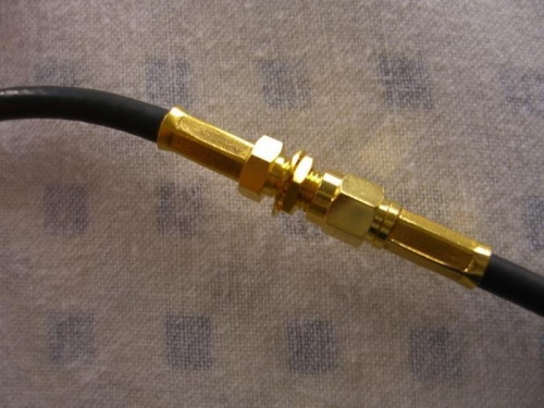

I installed reverse polarity SMA connectors to the FLARM B antenna cable as I need an extension to reach the FLARM unit.

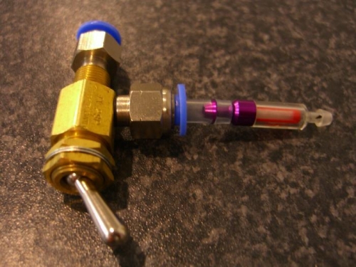

I'm still trying to decide on a convenient position for the alternate static source selector, I've fitted a filter & will try a few different positions this week.
Trial fit of spat
Trial fit of spat
Alternate static source selector
RPSMA connector
RPSMA connector
